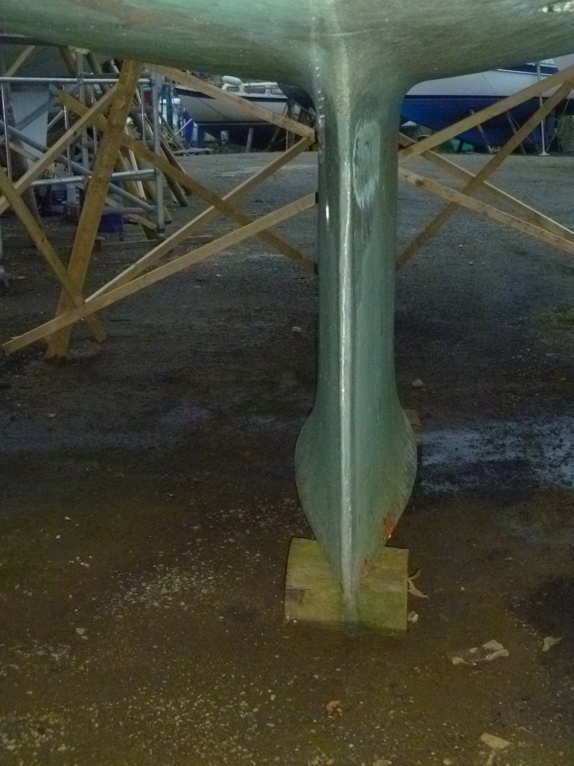

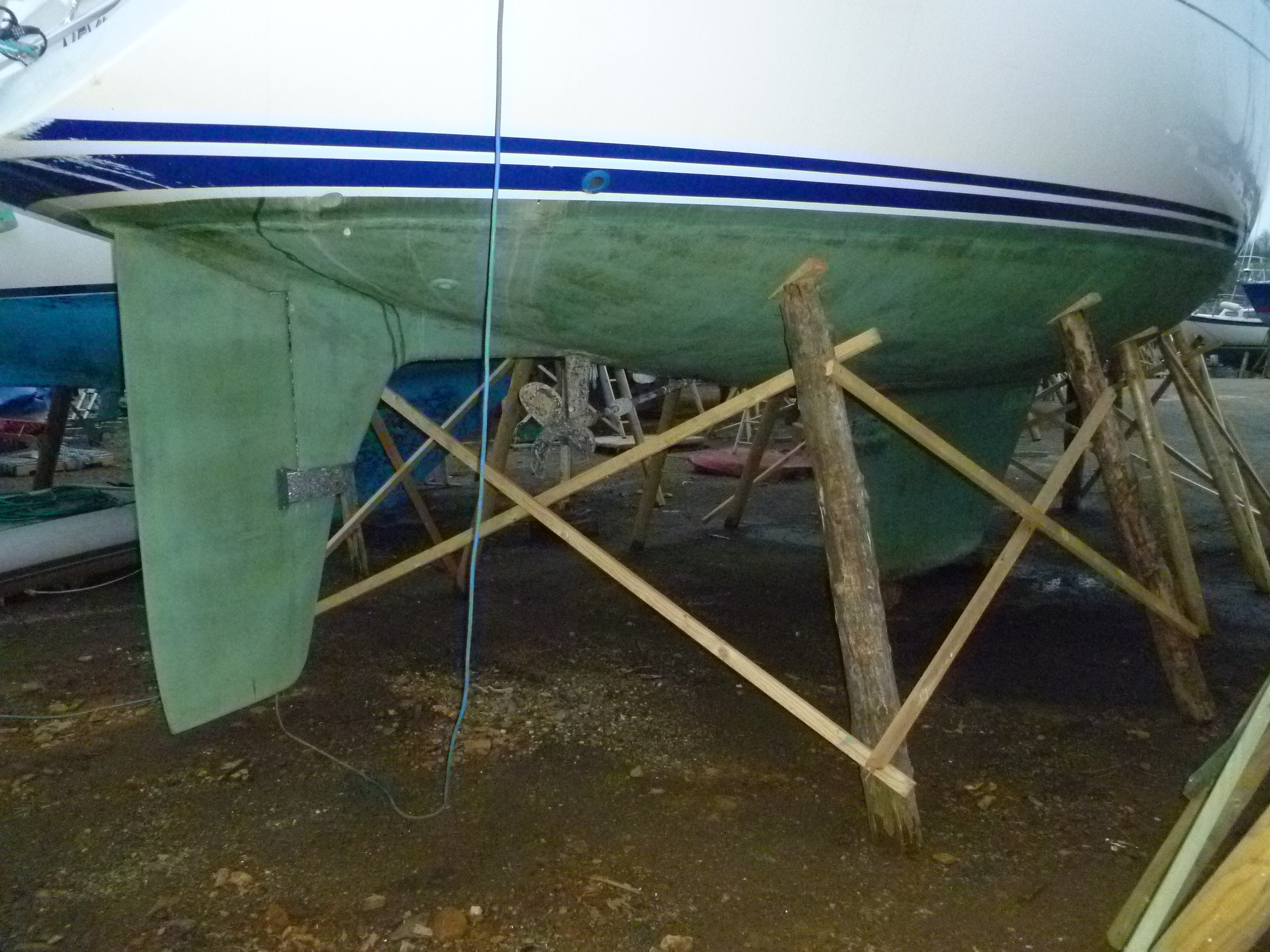

Surveyor Comment:
No obvious damage to the keel.
However there has been some repair/intervention at the forward and aft sections of the keel joint on both sides
There are some detached areas and also the joint is softer on the port forward patch.
Broker explanation:
The hull is coated in Coppercoat multi season antifouling, I think when this coating was originally applied, the hull/keel join was most likely bridged with coppercoat which is not very flexible, you can see where this join area has been re-coated by the last owner.
The photos don't really show much so should i request close ups showing the area?

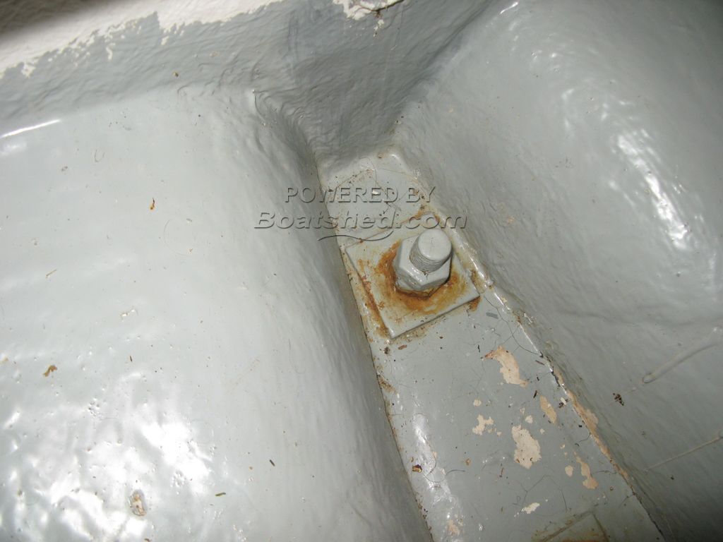

Surveyor Comment:
The galley sink seacock located behind the port seat back in the main cabin. While the seacock itself
was satisfactory and double clipped. There appears to have been some work undertaken in this area.
There is white paint surrounding the though hull fitting and unexplained rivets in the deck area on
the adjacent strut.
Broker explanation:
Rivets: looking underneath the berth, there is a metal retaining strut over the water tanks, these rivets are securing this metal strut. At some stage in the past, I think the port tank has been removed which is why these rivets have been re-done.
If you think this should be further investigated i'll need to request pictures.

Jon,
The photos do not seem to show the details mentioned in the text.
For comments, we would thus need detail close-ups (preferably with good illumination), otherwise interpretation of e.g. "some detached areas" is guesswork only.

Hi Jon,
I find it incredible with the cheapness of images today that someone can write a report like this without including photos of the questionable features he refers to.
Sadly, I don't think a photo will take you much further on the hull/keel joint. particularly if the work done there has been overpainted with Coppercoat. My suspicion is that some of the joint has been dug out and refilled on separate occasions using different materials. The correct sealant for this job cures to a fairly hard rubber which adheres very effectively to both the keel and grp - it sounds like a repairs have been done here using two different sealants of different hardness and the detachment suggests that the top of the keel is rusting so the sealant cannot adhere effectively. None of this is a disaster if the sealant problem doesn't go too deep. However, photos are unlikely to tell you how deep it goes.
The issue here is that the sea will continue to find its way into the joint causing rusting of the keel top and progressively further detachment until it reaches a keel stud. At that point the working part of the stud will start to corrode. The best test for this is to put the boat afloat for at least 48 hours then inspect all the keel studs in the bilge - if water is coming up any stud, the keel joint needs remaking now. Then lift her out and put her down on her keel, while watching the hull/keel joint - if water oozes out of the joint, it will need attention in a year or two.
The mind boggles at the thought of rivets through a balsa cored grp deck and I can't work out what a strut is doing in there, perhaps a photo will help in this case.

Hopefully the "rivet" photo will help clear up the mystery.
